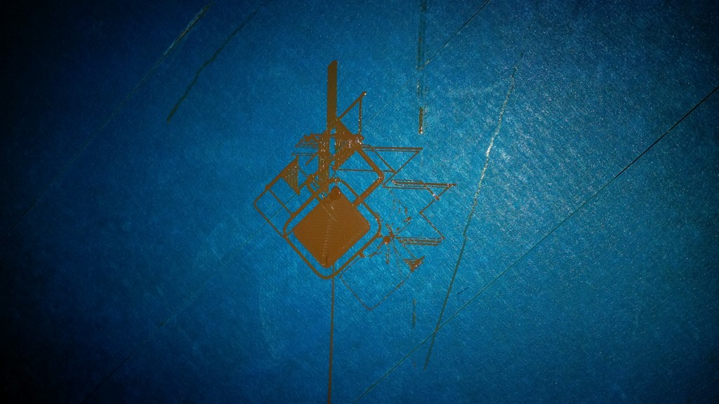

Basically everything seems to work fine for the first 30 seconds or so. Preheat, start process all works great.
Then once it gets to about 30 seconds in, the stepper motors start making clicking noises and stopping periodically fairly unnaturally. It will do a zig zag when it's suppose to do a straight diagonal line on the infill.
Watch this video of it in action. (I have the filament out so it's not suppose to be extruding, just watch the action of the pullies + printhead.) At this point it should be doing long diagonal strokes for the bottom layer infill.
It's not getting caught on anything and there isn't an abundance of friction on any axis. There is something electronic at fault.

As you can see the first 2 layers went down perfect and then clicking started and motor stalls. Funny thing this time though, the extruder motor was doing the same thing...

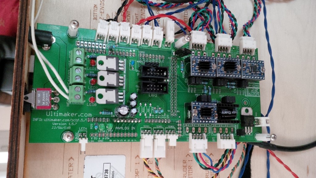

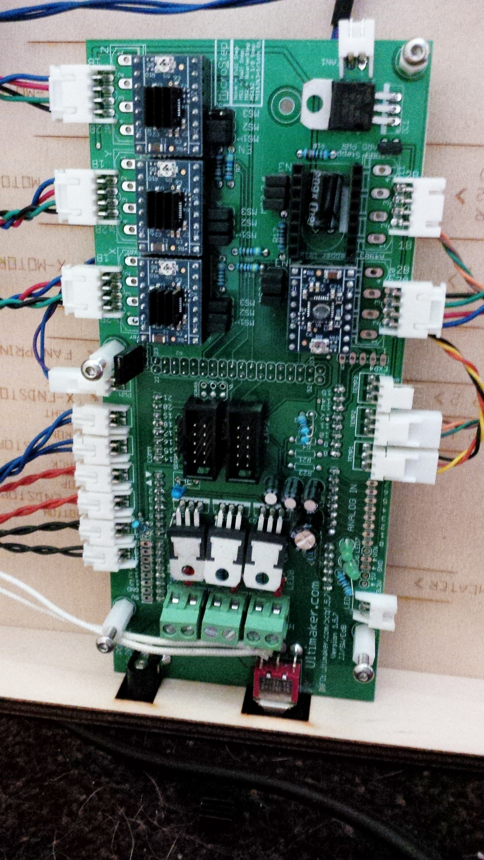

    I took pictures of both UMO boards.
    UMO1
    UMO2
    So here's the thing, apparently both mobo fans were kaput in some way.
    UMO1, the fan was shorting or something because after plugging it in for a few minutes the fan was SUPER hot. I could feel it through the label. Something must be shorting, in addition there was a burny electronic smell. I thought it was just weird stuff purging from the nozzle, but I'm convinced it's the mobo fan. I have disconnected it for safety.
    UMO2, the red wire on the fan had broken off so the fan hasn't been running. I soldered it back on and it seems to be working albeit a bit slowly. I successfully printed an Ulti-bot so I guess the fan had something to do with it, either a short or too hot or something... the cooling it provides doesn't seem very significant but it seems to be working so far.

    The stepper drivers are those blue 'squares', 3 in a row and 1 in the opposite.
    You can also see that on 1 of the 3, the black cube is missing.
    That black cube is a heat sink and helps the stepper driver cool down, when it is becoming hot.
    Obviously, the fan is helping the same cause.
    So the fact your fan is kaput, but it is missing also its own cooling you are probably over heating.
    On both pictures you have 1 stepperdriver with a heatsink missing, however on the second photo it is on the extruder motor, so that should not interfere with your X or Y movement.
