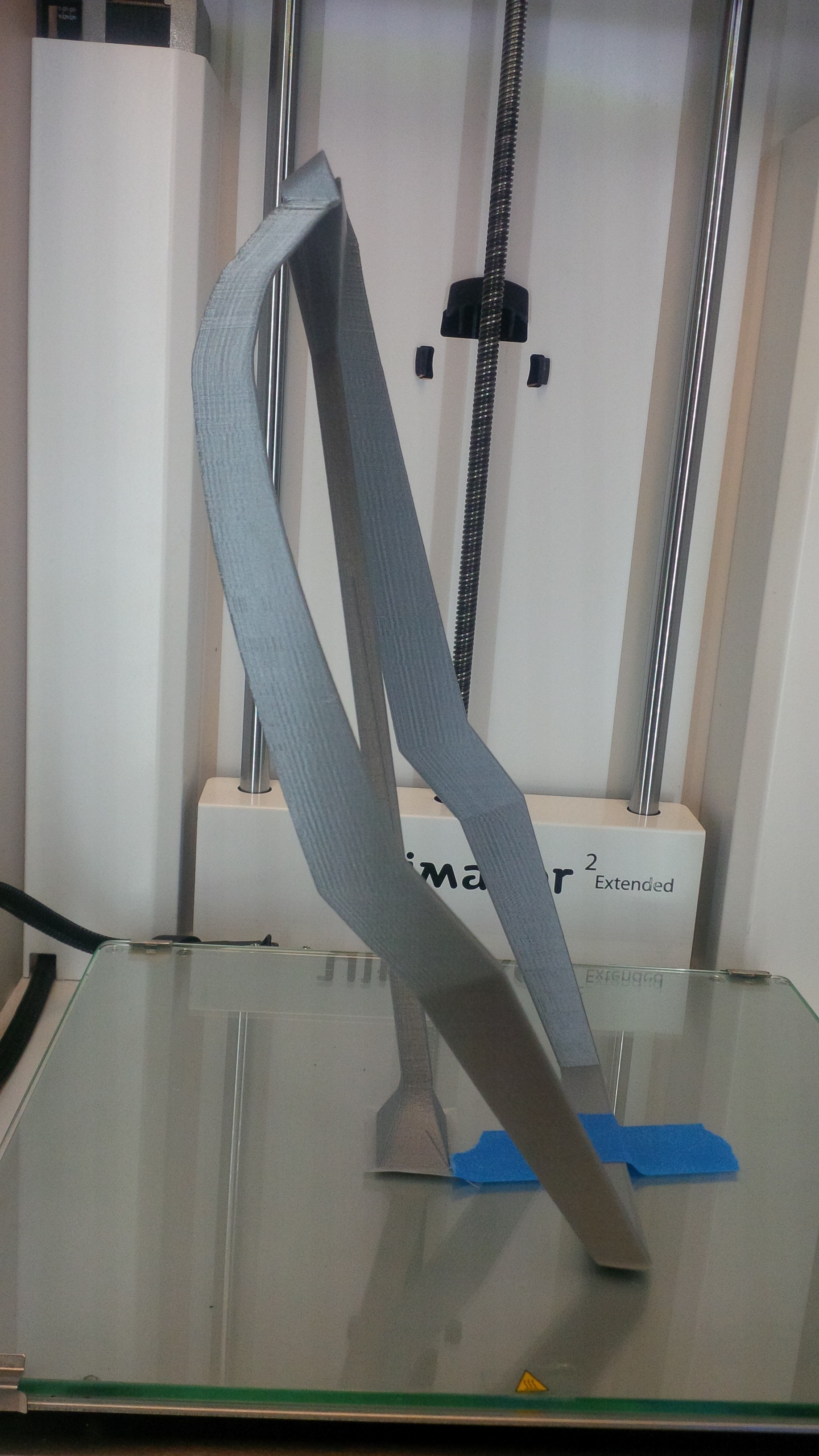

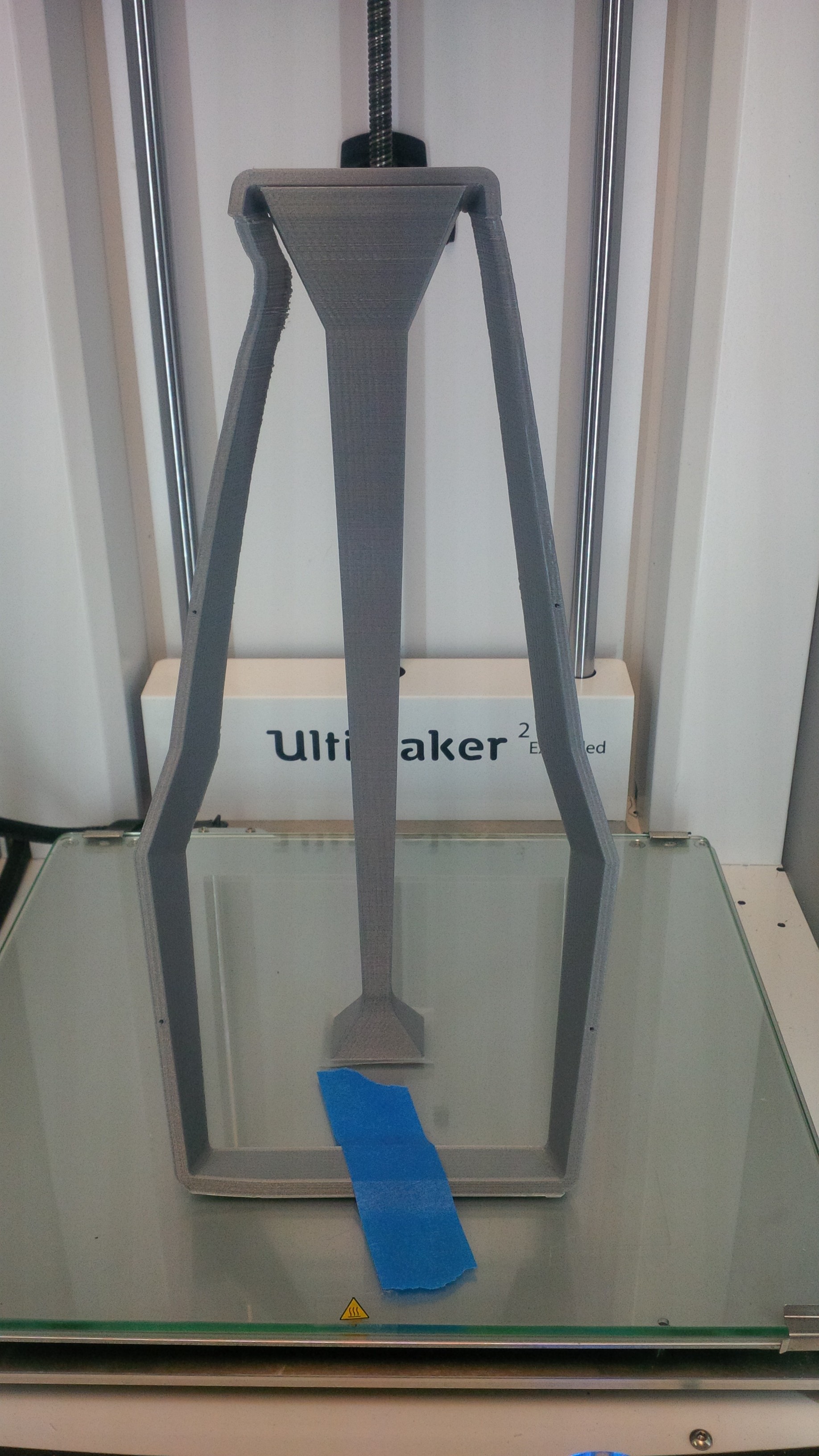

This student model mystifies me.  All the struts in this model are supposed to be straight, as viewed in Cura. We printed it in PLA on our Ultimaker 2 in the orientation you see in the photo, with the side that has two beams (fat and thin) across the front of the Ultimaker in the X axis, and the side with the un-bent beam running along the Y axis to the back of the machine.   As I watched the print, the unsupported angles did vibrate with the machine and the action of the print head, yet only the skinny angle beam in the X axis turned out curved (it is straight in the model) . . . . and an identically sized and angled strut in the Y axis was straight as an arrow.  All corners are exactly where they should be so this mates up fine to the rest of the model they designed, but the selective distortion begs for an explanation.
I'm an electronics tech and not a mechanical engineer so I my background is limited, but I'm going to throw out a guess here:  the unsupported front edge of the Ultimaker 2 build platform can vibrate up and down.  So the entire angle beam in the X axis is able to bounce up and down during the print.  By contrast, the beam printing in the Y axis is supported firmly at the back of the machine and only vibrates at one end.  WHY that would result in a curve beats me, but it's the only distinction I can see between the two sides.   And obviously, as you can see by the fat  angle brace in the X axis, parts that are thick enough to not vibrate don't have any problem at all.
Edited by Guest
    Posted · Why distorted print of 45 degree beam?
    The left corner has more cooling because the fan on the left side is closer to the nozzle (is this UM2 or UMO? Please update your profile but still same answer just more so for UMO).
    If it's a UM2 then the front two beams get more cooling as when it prints one the other gets more fan but the rear one doesn't get as much fan.
    Were your fan(s) at 100% that is critical.
    I'd print it a bit cool - try 190C. And slow - try 35mm/sec. And with max possible fan.
    Also it would help to support that back strut a little higher up of course.
    The thinness is a problem like you thought but also the overhang is a problem. A perfectly vertical rod/strut is easier to print.
    Another possibility - where does it change Z layers. I would expect it to be random on these 3 posts but maybe it always changes Z on the rear one? And so it does 2 layers right in a row and the lower layer is still not cooled yet when it starts the second layer - so every other layer is placed on a liquid layer below.
    Anyway all of these issues are helped with more fan and printing cooler. It's easier to print 2 pyramids than one as one can be cooling while the other is being printed. You only need a few seconds (3 to 5) to cool but on this part you don't always get that much time.
    Let us know what you learn.

    When printing this gray part in the "warped" region the left leg was leaning down too far and after it printed each layer the leg tilted over further and further. The printer kept bringing the leg "back" to the left to recover. It's a bit strange that it tilted so slowly and consistently. I'm wondering if it was above the glass temp in the base (bed too hot) but more likely it was peeling off the glass (not sticking well enough).
    The best fix is lots of cross bracing that your remove and discard after the print is done to keep things stiffer and less stress at the base of the print.
    I guess in addition you need more brim/glue/squishing to keep that part secured down onto the glass. Here's my standard spiel on getting things to stick like hell to glass:
    lifting corners, curling corners, part sticking to glass
    1) Make sure the glass is clean if you haven't cleaned it for a few weeks. You want a very thin coat of PVA glue which is found in hairspray, glue stick, wood glue. If you use glue stick or wood glue you need to dilute it with water - about 5 to 10 parts water to 1 part glue. So for example if you use glue stick, apply only to the outer edge of your model outline then add a tablespoon of water and spread with a tissue such that you thin it so much you can't see it anymore. wood glue is better. hairspray doesn't need to be diluted. When it dries it should be invisible. This glue works well for most plastics.
    2) Heat the bed. This helps the plastic fill in completely (no air pockets) so you have better contact with the glass. For PLA any temp above 40C is safe. I often print at 60C bed.
    3) heat the bed (didn't I already say that?). Keeping the bottom layers above the glass temp of the material makes it so the bottom layers can flex a bit (very very tiny amount) and relieve the tension/stress. For PLA 60C is better than 50C. 70C is even better but then you get other "warping" like issues at the corners where they move inward but if you are desperate it's worth it. For ABS you want 110C (100C is good enough).
    4) rounded corners - having square corners puts all the lifting force on a tiny spot. Rounding the corner spreads the force out more. This is optional if you use brim.
    5) Brim - this is the most important of all. Turn on the brim feature in cura and do 10 passes of brim. This is awesome.
    6) Squish - make sure the bottom layer is squishing onto the glass with no gaps in the brim. The first trace going down should be flat like a pancake, not rounded like string. don't run the leveling procedure if it is off, just turn the 3 screws the same amount while it is printing the skirt or brim. Counter clockwise from below gets the bed closer to the nozzle. Don't panic, take a breath, think about which way to move the glass, think about how the screw works, then twist. This may take 30 seconds but it's worth it to not rush it. You can always restart the print.
    If you do all this you will then ask me "how the hell do I get my part off the glass?". Well first let it cool completely. Or even put it in the freezer. Then use a sharp putty knife under a corner and it should pop off.
