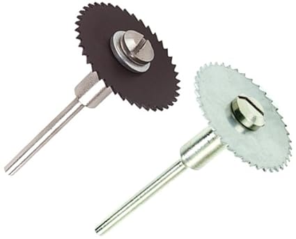

    I also talked about having the possibility to use single layer drawings, to draw your own support structure or open parts kinds of problems.
    Maybe this could help with your problem, you will have to have a solid, so you can print with spiralize, and cut the unusable part away,
    this way you can draw the solid, and you know where to cut, and leave a nice clean edge.
    I always cut, with one of these, they are very thin, and leave a pretty clean edge.
