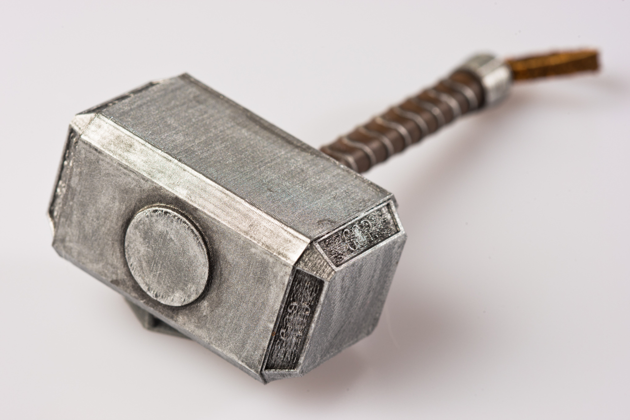

    What does your part look like? You can often design shapes into your object to reduce the warping. Especially for pieces you glue together, you can cut shapes out of the bottom so that it's not a solid flat surface which is what causes warping.
    This is the cap for Thor's Hammer I made: The Left keeps a nice flat surface, the right will peel the corners leaving an ugly gap. (This render is of the bottom surface of the part)
    Cut in little pyrimids near the edges and it should solve your problem. If you're glueing you won't see it and it'll save you a bit of material, but take longer to print due to the excessive amount of outlines.
    Let us know if that helps!
