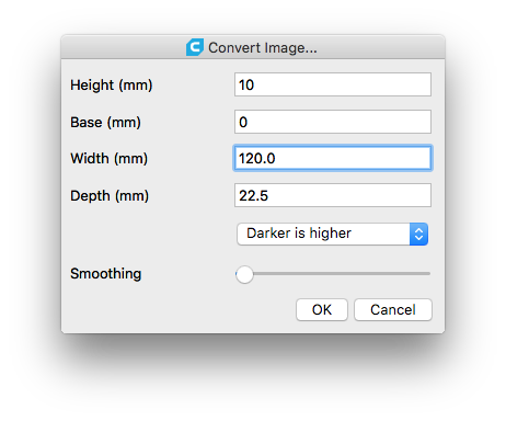

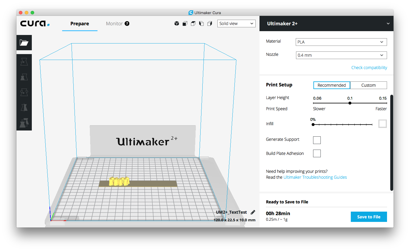

If you wish to go this route (Opening a bitmap into Cura) then do so with darker is higher.Then push the model below the print plate to cut off the base.
Although, the best way to do it is what geert_2 said.
