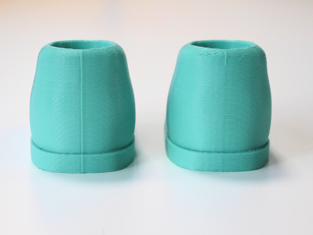

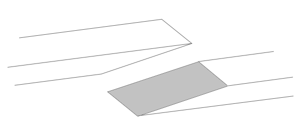

What is a scarf seam?
Scarf seams are a method of printing Z seams that is inspired by a type of carpentry joinery called scarf joints. A scarf joint is where you connect two pieces of wood by cutting the ends into opposing tapered angles that you can then fit together for easy gluing or fastening.  You can see what that looks like in the example image below, taken from Wikipedia.
AD_4nXcFpNwdYIZqI4ajfMLLb-7k6BXbUF8FwQ4Sl5wQpBm0mJr_d22_Fz7tLuv8wU1OROgavqQceQqbwZanMp_a9c1a_q4ooX8ERfWbWn4SHNZeN7acoJyjPjgYVJmhDtLougrL6GCdKVsr_xt2ORgqb-ryTtSo?key=LUMv8kTNUCJoSc4q0gTDsw
The principle behind a scarf seam is the same, except instead of cutting the filament, you create the taper ends by varying the flow rate of material through the nozzle. When first starting to print a layer, the flow rate is increased slowly in stages to make a line that is thinner at first and that gets thicker until it is the full line thickness, after which it prints at a consistent thickness until it approaches the end of the layer, at which point the process is reversed, tapering off the line so that the start and end of the layer match up. The result should be a Z seam that is less pronounced.
AD_4nXfNy20UzcK6Ld-U_Ku7oGaIQDfx1BJ26yN6cdffgAolOSMZwVS6egIUkLDzWjW4o50WQ7r_Pi0W6MnsKNyfD3D1w7vC991rMa86hzO0wpveUoh2_VFT-CHhmmSeAIsQVRZ0Y_Pq1XcfICuC4rjXFfvF5bc?key=LUMv8kTNUCJoSc4q0gTDsw
The image above is using our showcase model for this release which you can find, along with the settings used, here.
