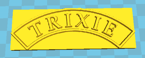

    Posted · Printing from pictures.
    Thanks for the instructions, cool dude :wink: , but that's not what I was after. Here's a picture of a name plate for a model steam traction engine:
    Here's what Cura produces:
    I want the model to follow the outline of the name plate.
    ( by the way, mine is a microsoft-free home, so I couldn't have used zsurf anyway :-| )

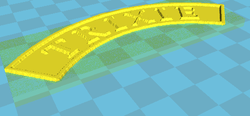

    Well that's easy! First make it so that in the image, the space around the letters is not the same color as outside the curved area. For example the letters and border could be black, the background white and the spac around the letters could be gray. Or a very light gray.
    Then pull it into cura like you already did and under "advanced" "quality" "cut off object bottom" set this to maybe .1mm or 1mm or whatever it takes to get rid of that outer area.
    Trouble is, I need the base & that's what causes the rectangle ( I'm using Height 1.5 & base 4 ) & that's what I want to follow the profile of the border. If I cut off the bottom, I just cut a bit off the base :-| .
    I could do as you suggest then print a seperate base from another model then stick them together, bit it would be good to print it all in one.
    No. You don't get it. The reason you print *gray* around the letters is so that the curved part is HIGHER than the rectangular base. Then you use that "cut off object bottom" to cut off the rectangular part but *not* the curved base. Just try it - put a 50% gray around the letters - in the curved section.
    You can also create a slope to the letters by blurring the edges of the text slightly and having that be a dark gray. Although you say Cura already takes care of this.

    I understand what you're saying. Here's what I get:
    So yes, I've lost the rectangle, but I've also lost the base, so the model iis too thin to use as a pattern :-|
