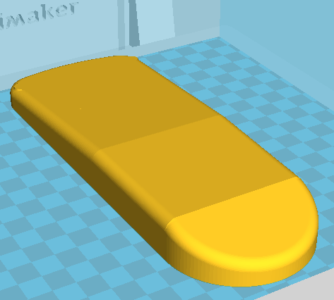

I successfully printed a large oblong tray, about 180 x 70mm and 19mm tall.
Using Win-7-64, Cura 15.02-RC2 and the Ulti-controller. For appearance the convex side was printed up so it needs a lot of support. Zero problems with Cura.

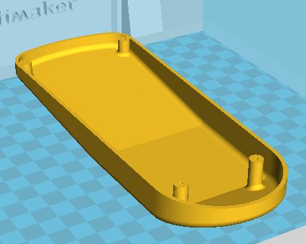

On the same tray I added four small mounting studs and a 3mm hole.
The CAD model looks perfect.
The view in Cura looks perfect.

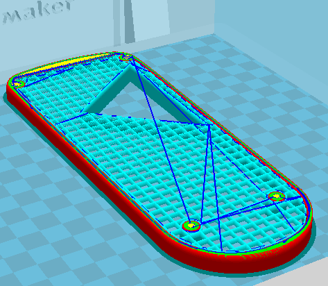

When slicing it in Cura a very large 60x60x60 triangular area inside the upside-down tray is missing the support. One node of the triangle is near the 3mm hole.

  • I turned it the concave side up.

  • I removed the hole in the CAD file. The support structure changed but is still way wrong.
The 3D rendering looks perfect. It is just the support structure that is wrong. It is hard to fix the CAD file if it is that is wrong when it visually looks perfect.
It is difficult to explain and visualize the error so I linked some pictures.
