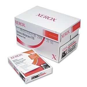

    240C is too cold if you want good layer bonding. I've printed ABS and it had "okay" layer bonding but compared to PLA it was weak. I'm not sure what the correct temp is but 240 or 245C is definitely on the cold end and you can get these layer separation issues.
    Fan at 25% should be okay but I recommend with ABS that you put a box over the top and cover the front with clear plastic to get it up to about 60C inside (don't go much hotter than that because the steppers get too hot).
    A photocopy paper box is the perfect size to put on top of the printer with room for the bowden:

    I have to see what i have in my house to build a nice enclosure.

    So, i did all those things:
    Raising the temp a bit (245-250°C)
    Closed almost all the open end (actually just the front one...)
    Fans at 10%
    And it worked. Thanks a lot!

    This is genius. I have been all over ABS forums and this is by far the best and easiest solution I have seen for keeping in heat. It's as if the Ultimaker 2+ was made to have this box on top of it.
