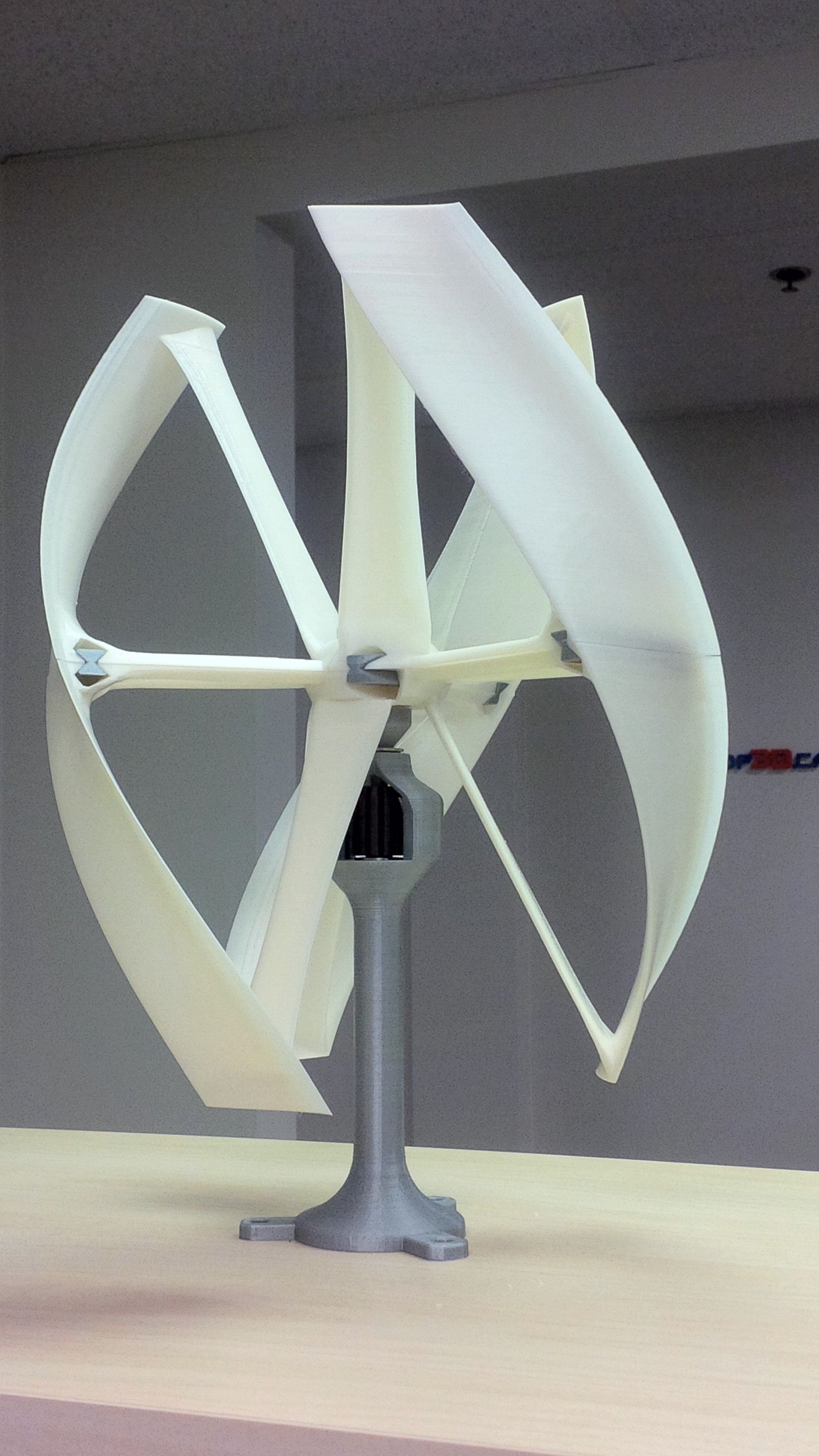

I'm gonna take a wild guess and assume this is about print settings. Sorry I can't type german or dutch? I dunno...
Anyways, these are the settings I've had success with:
Layer Height 0.15mm
Shell thickness .8
Fill: Top/bottom thickness 0.6
Fill density: 0
Print speed 40mm/s
No support
nozzle 0.4
Initial layer thickness 0
Travel speed 170
Bottom layer speed 15
All other advance speed values: 0
minimum layer time 10
Here's the catch though. While the above prints better for a visual model, it makes it too heavy... Ideally you print with 0.4 perimeter, and hollow (even better on 0.25). But it is much more difficult to get a good print.
Obligatory picture.
1
GolaxR6 21
