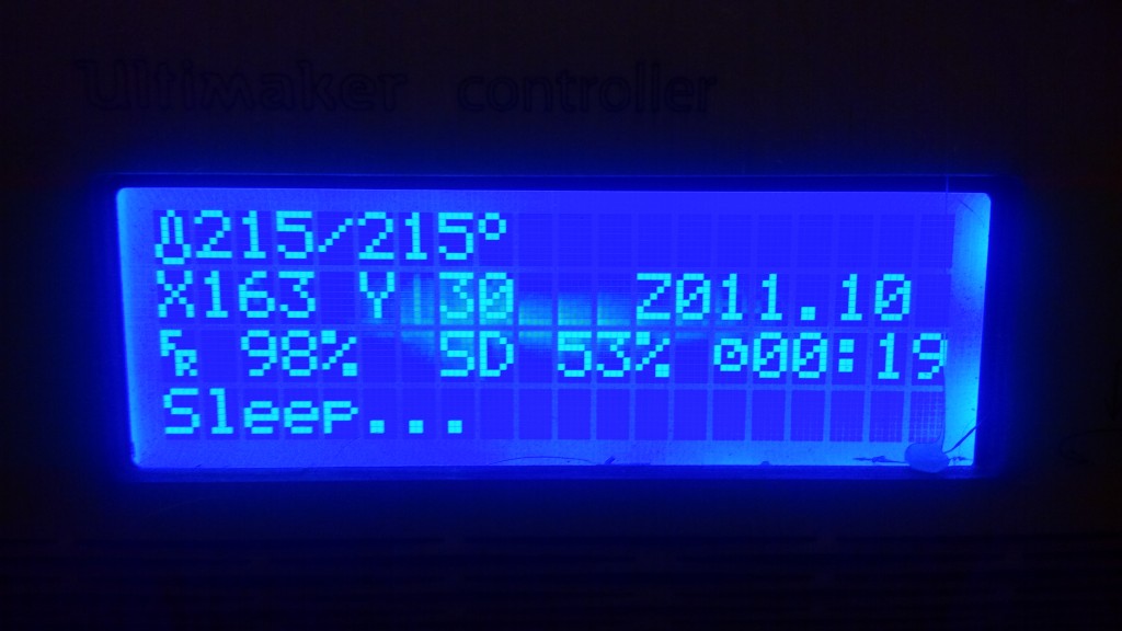

ahhh, ok, that explains it, I was playing around with that feature. Didn't think of it because it seemed so active even while it was 'sleeping.'

The sleep message usually appears if a layer doesn't reach the minimum layer time and the cool head lift feature in Cura's expert settings is enabled. Sometimes messages just stay longer than they should.
