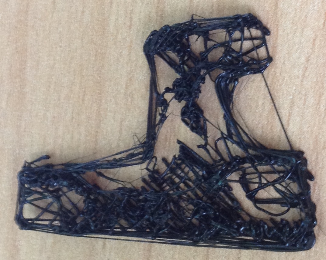

Derlin parts come as one, but you got to make them two, and assembly like instruction says.
Then, I think you may have same problem I did.
My first print here:![IMG_1311.JPG](http://www.matlosz.pl/um/IMG_1311.JPG)
Solution is to set in gcode "M92 E850", that made more PLA usage for printing (I have Marlin FW).
