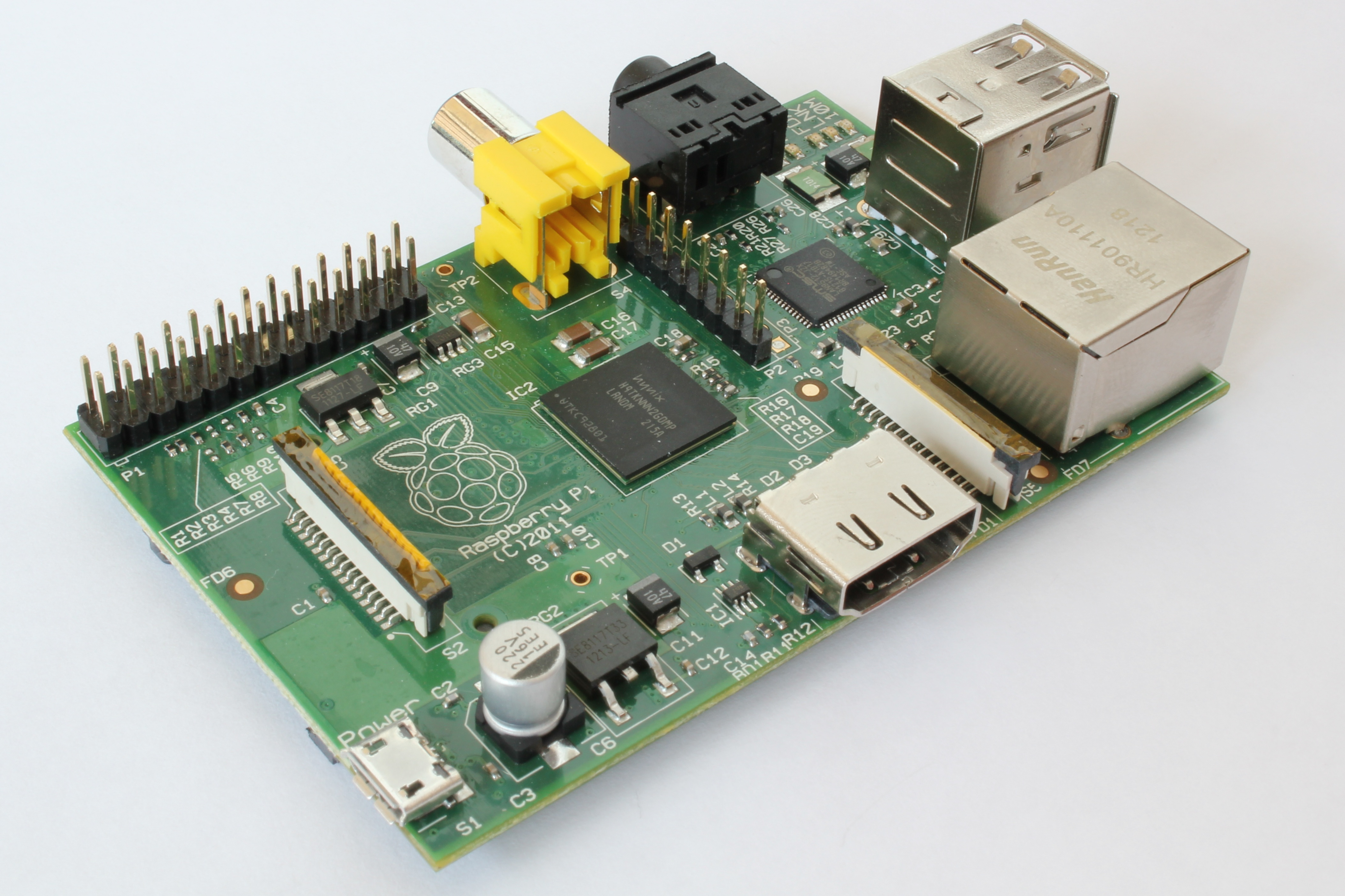

    Bonjour a tous,
    Je viens juste de finir l'installation d'Octoprint sur un Raspberry Pi pour utiliser mon Ultimaker 2 à distance. J'ai suivi les informations données sur plusieurs sites donc je me suis dit autant rassembler tout ça pour éviter a d'autres de perdre du temps.
    La plupart des infos sont trouvables sur le net.
    De quoi avez vous besoin?
    Un raspberry Pi:
    Le Raspberry Pi est un ordinateur low cost de la taille d'une carte de crédit qui se branche sur un moniteur de pc ou sur une TV
    Je recommande de prendre le modèle B car il a deux ports USB qui sont nécessaire si on veut l'utiliser en WIFI

    Hi all,
    I just finished installing OctoPrint on a Raspberry Pi to use my Ultimaker 2 remotely. I've done this by following a couple of steps found on the internet so I'll just give you a step by step on how to install it for the Ultimaker 2.
    Most of the stuff can be found around the web.
    What do you need?
    A raspberry Pi:
    The Raspberry Pi is a low cost, credit-card sized computer that plugs into a computer monitor or TV, and uses a standard keyboard and mouse. It is a capable little device that enables people of all ages to explore computing, and to learn how to program in languages like Scratch and Python. It’s capable of doing everything you’d expect a desktop computer to do, from browsing the internet and playing high-definition video, to making spreadsheets, word-processing, and playing games.
    I'd recommend buying the model B as it has two usb ports which are necessary if you want to make it wireless.

    5. Set up Wifi
    Just click on the wifi config icon and configure your wifi.
    Source of explanation: http://www.howtogeek.com/141157/how-to-configure-your-raspberry-pi-for-remote-shell-desktop-and-file-transfer/all/
    Use OctoPrint
    Now that i finally made my raspberry connect with wifi I could connect it to my Ultimaker 2.
    Simply plug in the usb that is delivered with your printer.
    You should be able to access it at http://octopi.local
    If you are running Windows, you might need to install “Bonjour for Windows” http://support.apple.com/kb/DL999 first for this to work – or alternatively at its regular IP.
    To connect with an Ultimaker 2 set the baudrate to 250000
    You can then upload your gcode directly to octoprint and watch all the magic in your web browser.
    You'll need to set the gcode flavour to reprap in Cura for this to work (File -> Machine Settings).
    I've done all of this yesterday so i thought i would share all this if it can help someone.
    Octoprint looks very nice and usefull you can monitor your prints with the gcode visualizer or check your webcam to see if everything is ok.
    It is possible to make your OctoPrint available from everywhere but i didn't do this, i don't want to make it possible for anyone to access my beloved ultimaker if i mess something up in the configuration.
    Anyway to access it i installed teamviewer on my pc (which has then to stay connected while i'm away and need monitoring), i then access to octoprint remotely by connecting to my pc. It can even be done with your smartphone.
    Hope that this little tutorial will help. Any more advices, remarks or insults are appreciated :)
