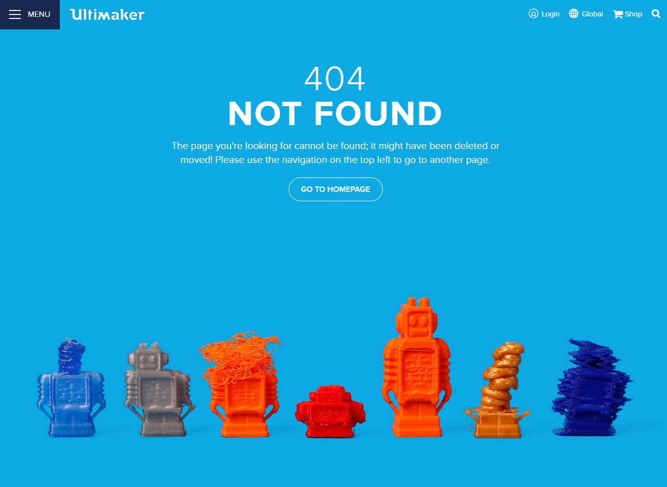

We used to have this as our 404 page:
![Image](https://pbs.twimg.com/media/FomaY1EXgAIwhf3?format=jpg&name=large)
It shows pretty common errors .
So from left to right:
1. Filament got stuck to the nozzle
2. Belts not tight / missing steps
3. Filament didn't stick to previous layer
4. Steps not calibrated
5. Steps not calibrated
6. Same as 1
7. Steps not calibrated? Not quite sure what that one is
