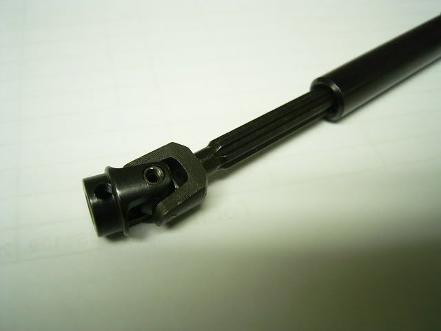

    If you want to do this I would use a sliding spline driveshaft from an Radio Control Car. You can get
    really nice carbon filled plastic components for those things. Super light.
    Something a bit like this, which is from a Tayma RC truck...1/14 scale.
    http://i1233.photobucket.com/albums/ff3 ... MG1721.jpg
    Could work, question is by the time you add all that stuff on...will it be light !

    The Motors are positioned on top of the Ultimaker and therefore the Movement is just for an Area of 22x22cm and the Shafts are not tensioned much. If you think they are positioned like the Filament Feeder, that's wrong. The Part snowygrouch has posted is not my Idea.
