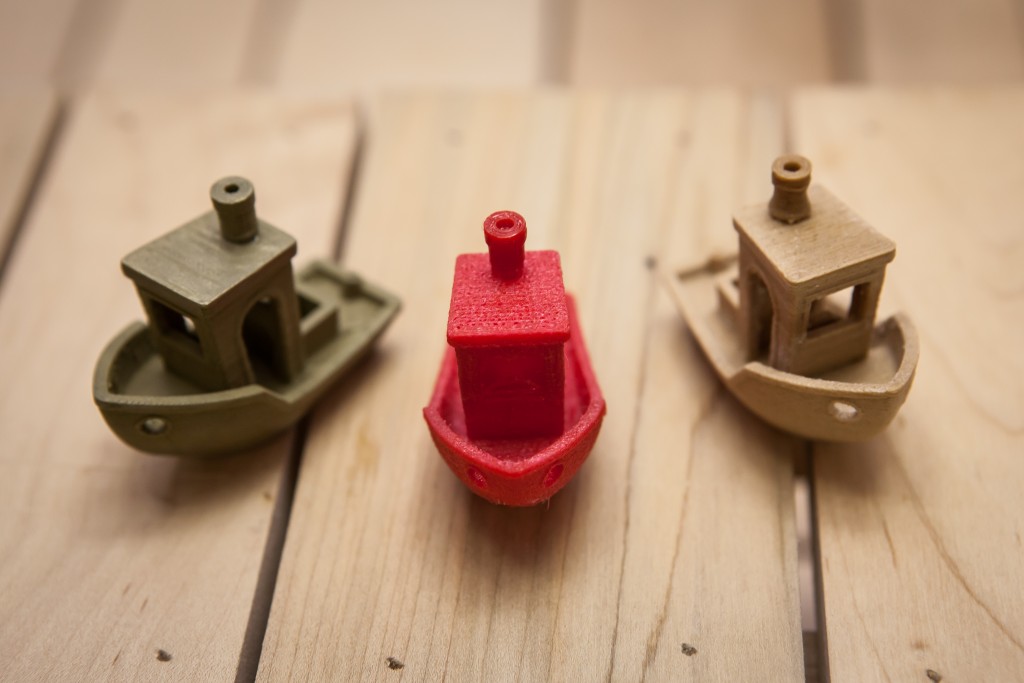

    You can do it. I printed it on a stock UMO+. It's kinda like a wet noddle inside the tube. but it somehow works. You need to slow it down to about 20mm/s however. And it feels like you're printing with nozzle ooze. but it works.
    Here's a Mic Shim I made for an FS7
    And a bency (middle)
    The others are woodfill and bronzefill.
    The finished texture is like a slightly pourous rubber. I could be under extruding or going a little too fast however so mine has a bit more air gaps than normal.
    You can use this to your advantage though. If you purposefully under extrude you get an even softer shape. It's also quite strong, it stretches a decent amount and difficult to rip.

    Thanks Valcrow, think I'll give it a shot. What's the worst that could happen

    Really annoying clogs. When it does clog it's not quite as easy to clear as normal PLA because of it's stretchy nature.

    Prepare to spend a lot of time tweaking settings. Also, using the stock feeder is a crap shoot, it could work if you're lucky or it might not.
