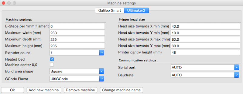

As I understand, the center point has been moved in the current version of cura. Should serve that if one uses the button "center on platform" (with one printhead), the print will be placed in the middle of the buildplate.

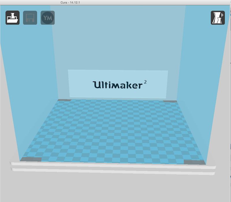

    I added an offset to the 3D buildplate, because the nozzle is actually on the left side of the printer head. So this area you see now, is actually where the nozzle can get to. And thus, it needs less space for the right clips. Giving you slightly more build space (yay!)
    Posted · Build volume quad positioning
    In the past I noticed that when the print head follow the far right side, the side of the right fan and screws will scratch the side panel. Is that still possible?
    That's not changed. And it depends on your UM2 build if it can scratch the sides. The official clearance is quite small, and if you slightly bend the fanducts it can already hit the sides.
