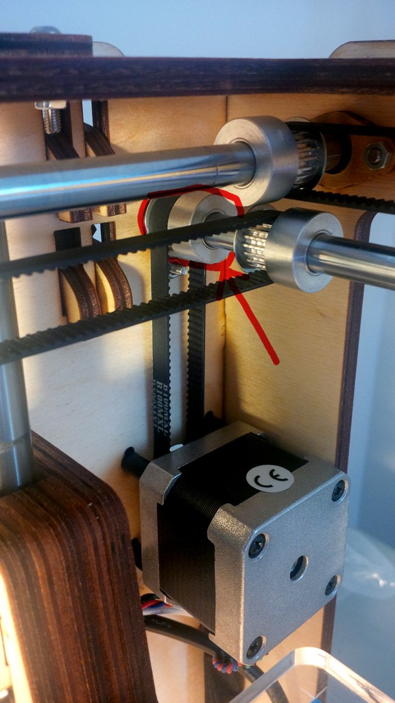

I hoped my first post here would be a positive one with some awesome prints, but unfortunatly my new umo+ printer does not work..., I hope you guys can help me or give some tips.
(I have contacted support yesterday, but haven't heard from them yet)
I had a lot of fun building the unit, but I have not yet printed out a single correct Ultirobot print :(
Despite all the efforts of: lubricating, axis aligning, pulley checking, loosening the end-caps, reinstalling the newest firmware and cura, new gcode exports and making sure if the printhead can move without to much friction.
(advised by this site: http://support.3dverkstan.se/article/23-a-visual-ultimaker-troubleshooting-guide#shifted)
The problem is the stepper motor, it was quite noticeable because it produces a clogging/low clicking sound when it shuts down for cooling down and messes up the print. 3dverkstan advice is to lower the current to the stepper motors. But I can not find this option in the ulticontroller menu so I presume I am overlooking the option... where can i find it?

    Check your pullies first before being totally convinced it's an electronics thing.
    If one of your Y pullies is loose it will show symptoms as you've posted them. (although usually a bit more of a slant) Where the layers will shift only in one axis. This is especially common building your own printer. make sure to REALLY tighten those set screws on each pully.

    I had the same thing on X on my UM2 last week and it was the pully on the motor axis. so best check and tighten all pully's while you're at it.

    I checked every pulley multiple times before posting. ;)
    Unfortunatly this is not the problem, would be much easier to trace and fix..
