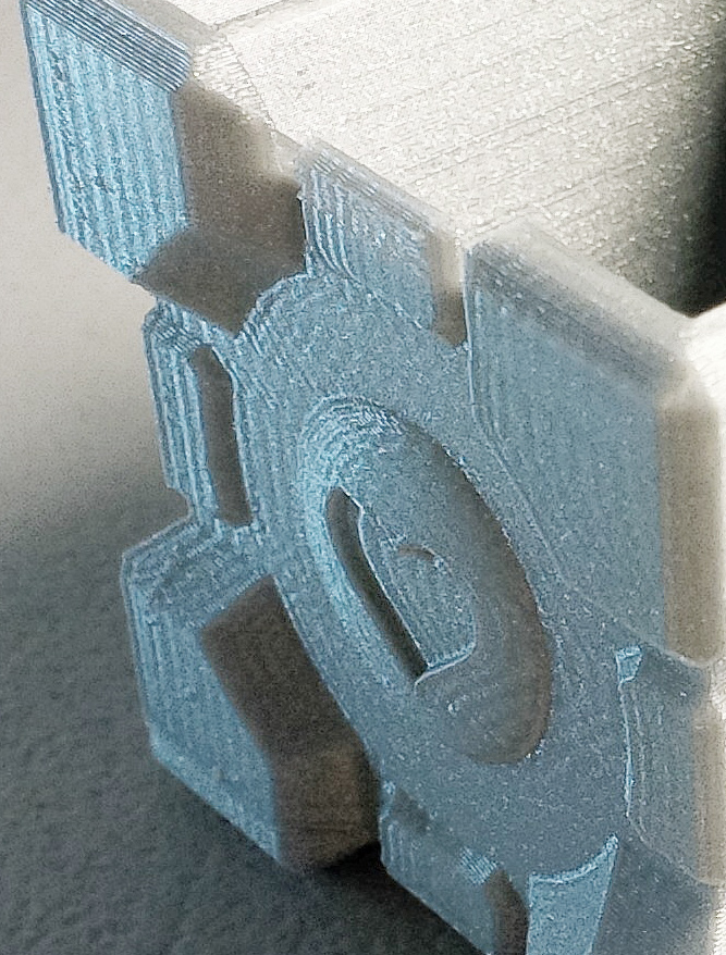

I usually print small detailed angular things, this has been a huge thing I've been toying with over the years. Frame rigidity & the surface it sits on plays a big part in it too besides just the acceleration. The more micro 'wobbles' the worse it gets for small 90 degree angles.
like you I've found around 1500 works best for UMOs.
I run 2300 on my UM2's
and leave the default 4000 on the UM2GO.
The small frame of the UM2GO lets that thing go at full speed without introducing much ringing artifacts. it's awesome.
While lowering acceleration helps the ringing artifacts, it seems to affect the top surface quality. It slows down as it reaches the perimeter sometimes creating thicker fills near the edge, and thinner (sometimes apparent line separations) in the center top of your print. So consider this when making big flat top objects.
UMO print at 4000 acceleration
UM2 Print at 1500
For your ringing test, consider adding some small grooves on the side. That stuff rings like mad.

Nice photo! That really helps illustrate the ringing effect.
It's cool to see you land very near to me on max acceleration, independently. I agree on the top layer infill aspect as well. I think the narrow rectangular infill section on my part should provide an exaggerated version of that, since the head is constantly in a state of acceleration, likely never hitting commanded feed. If you can find a setting that provides fairly uniform extrusion on this test part, there shouldn't be a worry on a live part.
On the grooves, do you mean a vertical, square profile groove? I could definitely add those in, but was thinking that the two 90* OD corners would show the same thing. One corner shows the Y axis coming to a rapid stop, with a pure X move following to show any ringing. the other corner shows X stopping. Thoughts?

    How do you know if the ringing is mostly caused by the shafts or in the rubber belts?
    Well I guess we could think about the frequency. I'm going to estimate the frequency within about a factor of 10. Looking at the companion cube I'm going to say the rings are 1mm apart and guess the head was moving at 50mm/sec (much faster and it would have been still accelerating and they should be noticably closer together nearer the edge when head is moving slower).
    So that's 50 rings per second (50mm/sec divided by 1mm). That's a very low frequency - I doubt those steel shafts wobble that slow - much morel likely the belt I think. And if you double the tension on the belt the frequency should double (lines twice as close together).
    Now this is rough so it could be 10Hz up to maybe 200hz. Those are mostly audible frequencies (low pitch) and again the belt is about right for that.
