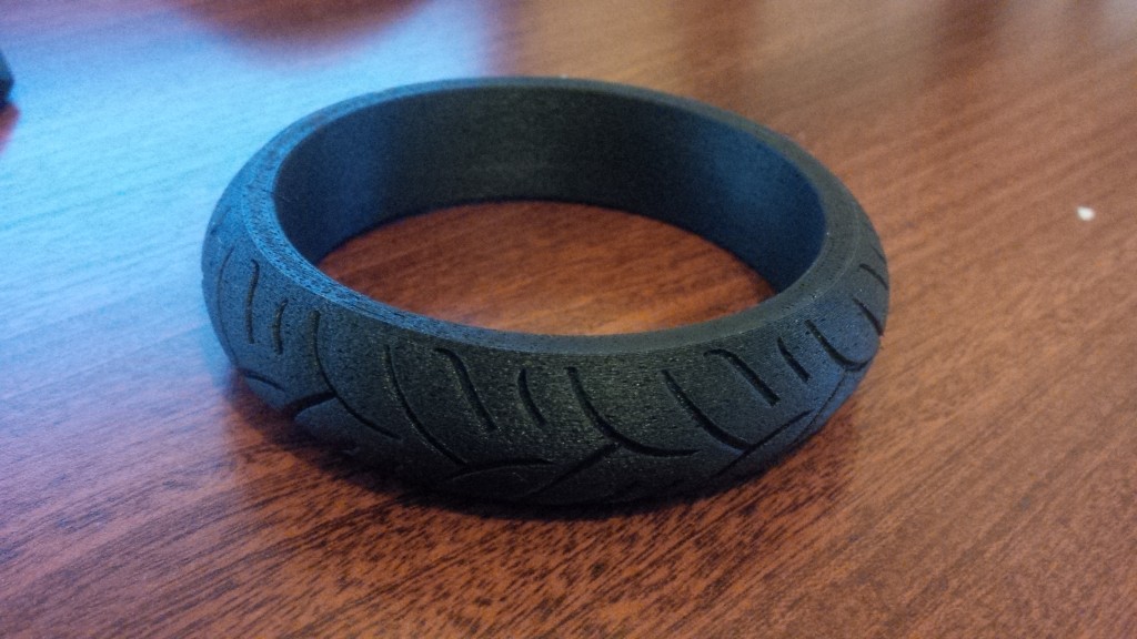

    I tested the UM PLA FLEX a few days ago. And was very impressed! It is FAR easier to print than Ninjaflex, but not as flexible.
    I printed on a stock UM2 with standard feeder, and it printed great first time with PLA settings. I printed at 15mm/s, but I think it could have gone faster. I never had any luck with Ninjaflex at anything faster than 15 so thats where I started.
    I printed a hollow ducati tire, and it came out flawless. Looks better in real life than the picture.
    The layer bonding doesn't seem quite as strong as ninjaflex (it tends to crack along the grain if its bent sharply) but it certainly has a much better finish. Slightly harder than Ninja flex as well. But at least it requires no additional tinkering of your machine.
