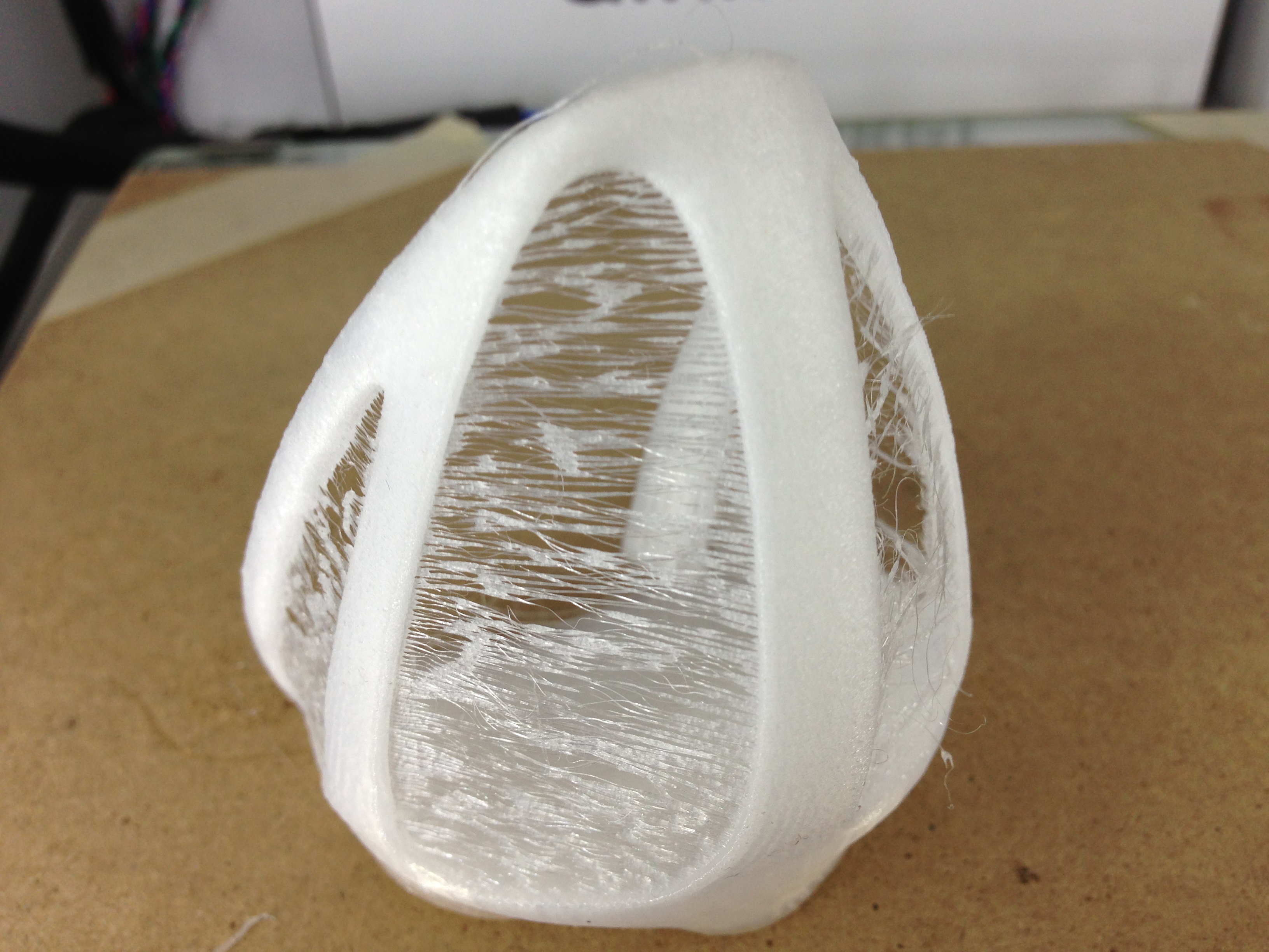

    The other issue is threading. Retraction doesn't work. Actually it prints better without retraction.
    What happens is that nylon 'pulls out', because it is formulated to approximate silk.
    So you get a bunch of threads that are soft and strong...they don't pull off, you need an exacto knife.
    I think the threading can be solved.

    Another update...Finding that retraction helps, but it just doesn't work as well as with PLA.
    So it's probably figuring out retraction settings to work with nylon. Currently it doesn't look like you can make the retraction go faster on the machine settings, but I suppose that might get fixed at some point.
