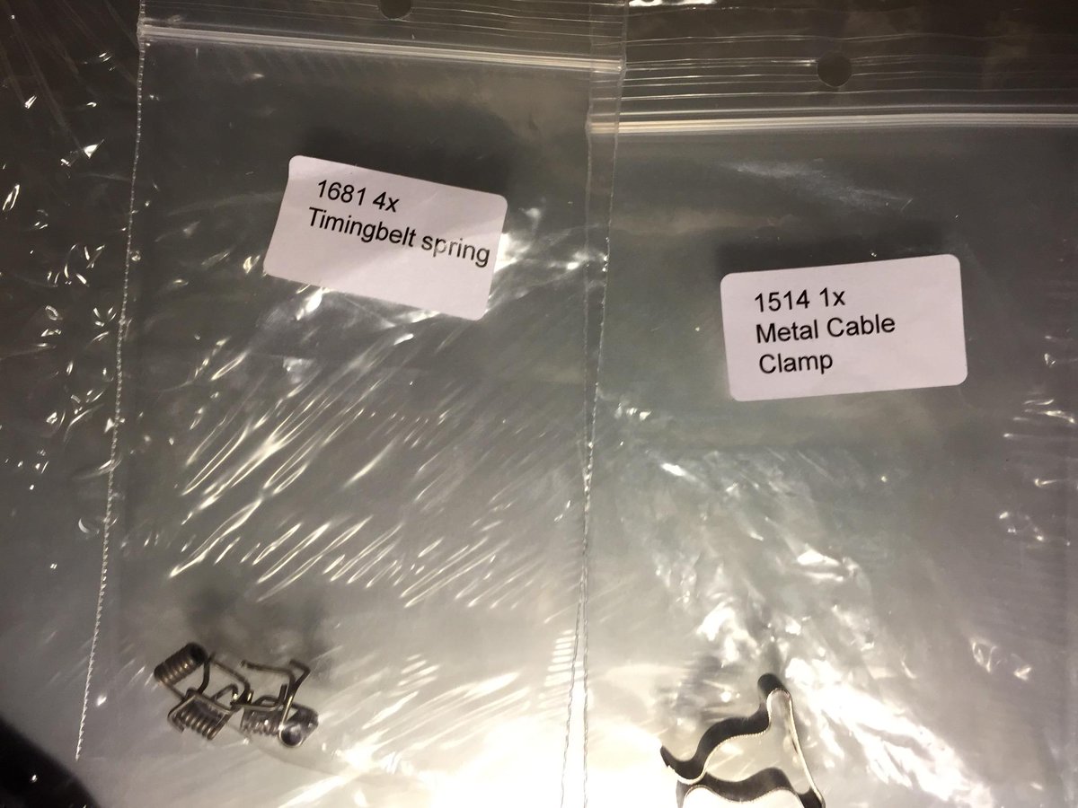

    Hi I just got my UMO+ from Imakr (assembled) and they left me 2 bags with items. The 'timing belt spring 1681 x4' and other think.
    Where exactly must I place it? Any photo for a bignoob like me?
    Also. What is the 'Metal cable clamp 1514 x1'? And where does it go?
    They forgot to put the calibration sticks that are used to align x/y so for now I can't print :D
    Edit. Photo of the 2 little bags

    Ok I found the 'documentation' on that Timingbelt spring...
    It's ofc, on somewhere else, on the Ultimaker 2 Assembly Manual
    um2 assembly manual V1.1 _english.pdf
    So I place them just outside like any other tensioner from youimagine or it's better to open everything?...
    Btw if anyone can tell me where the Metal cable clamp goes...

    about the tentioners, on the UM+ there is no "inside" to the slider blocks, so you would need to put them on the outside of the belt just like any other tentioner printed from youmagine. I also use the microwave V2 model from here (they are great): https://www.youmagine.com/designs/microwave
    about the cable clamp. I just put mine on the side to hold the heated bed cables as shown in this image:
    https://ultimaker.com/img/ultimaker_original/quality1.jpg
    I don't think it's super important to have that clamp...it's not in the assemble notes for the UM+
