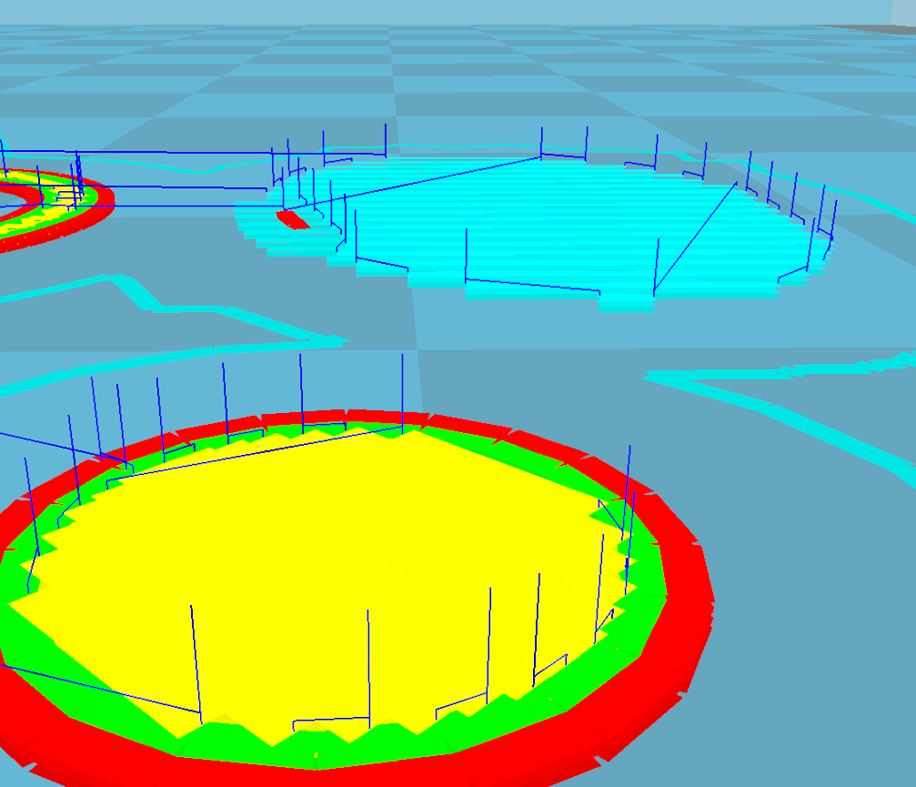

    As gr5 already mentioned. Check if it really retracts where the strings are. Just open layerview in Cura and check if there is a blue line that goes up! (those mean retraction). If cura does not retract there you have to change minimum travel in the expert settings. set it down till the upward line appears. I would not recommend to set this to 0, because it will then retract everytime it starts a new line, even in the infill. as shown https://lh4.googleusercontent.com/R4bWf9jQhmMmcfBmGVuc4-eM7Nu27DDfeaf4llTXtw4=w1007-h865-no

    As gr5 already mentioned. Check if it really retracts where the strings are. Just open layerview in Cura and check if there is a blue line that goes up! (those mean retraction). If cura does not retract there you have to change minimum travel in the expert settings. set it down till the upward line appears. I would not recommend to set this to 0, because it will then retract everytime it starts a new line, even in the infill. as shown here
    Nice thing! I'll check it.
