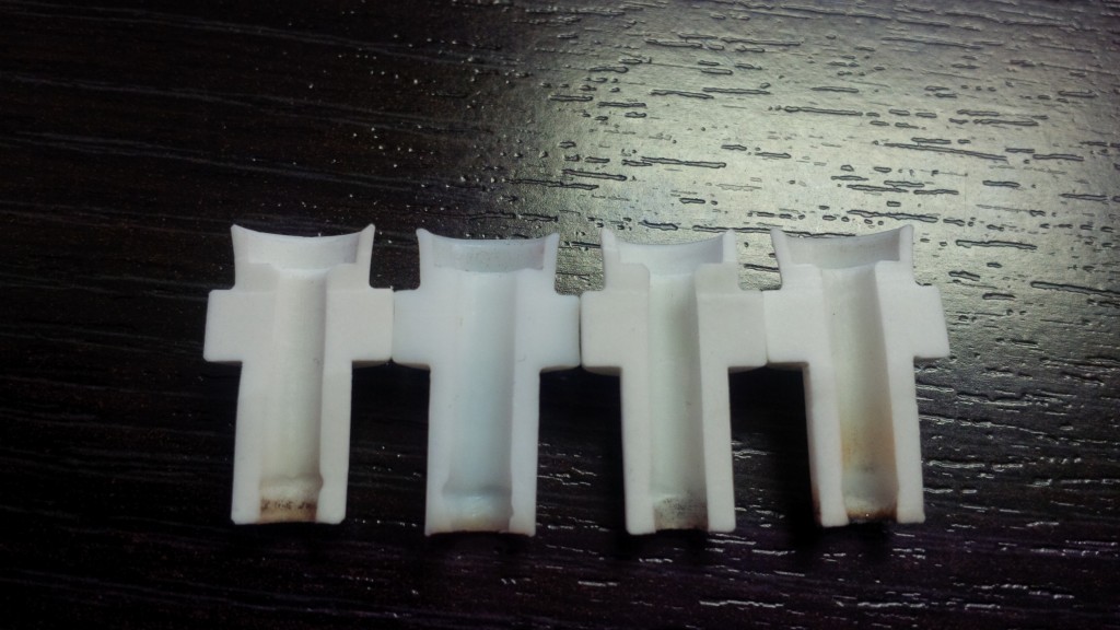

If you get a nice impression of your nozzle it's usually not the TFM, check the nozzle next. I've had some nozzles that just don't print well because there is buildup at the tip, it cleans well and everything so I would try with another nozzle if you have an olsson block. If problem persists then it's not the nozzle.
Also a drill bit passed through the TFM doesn't really reveal the problem because it's usually the cavity that causes the issue. The cavity 'catches' molten plastic, and it cools which ceases the whole system. So usually it'll break down when there's any sort of retraction.
Here are a few spent TFM's cut in half. A drillbit or filament will pass through that just fine.
