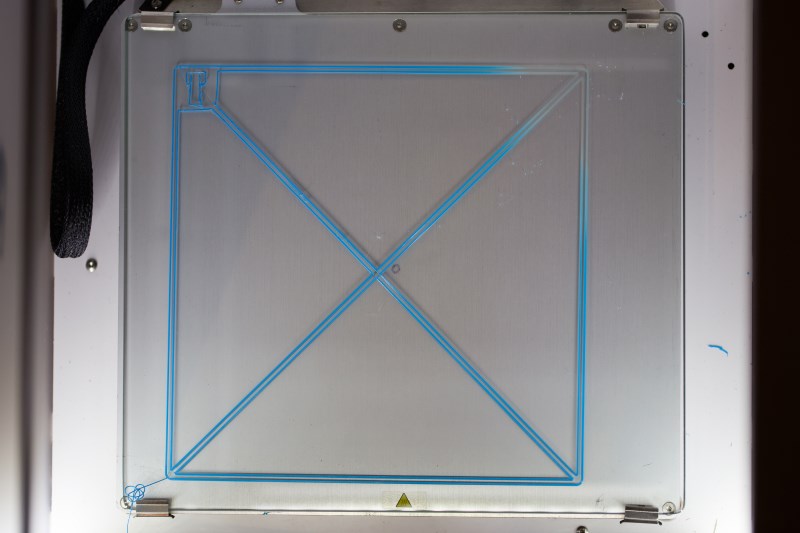

I am trying to level my bed. and I'm constantly failing to the point where I lose interest...
I ran about 20 levelling cycles with varying every variable which i think has influence the correct levelling (glass plate orientation, heated/cool bed, heated/cool nozzle).
the 3 points of the levelling wizard are levelled near to perfection by using 80g/mm²-paper.
But no the rest, i have 2 troubling regions, where on one the nozzle is touching the glass and on the other the distance nozzle-glass is too far for the filament to stick
I hope you can understand what I mean by looking at this print.
model: Bed leveling test by imitation
you can view this photo in higher resolution here
as well as detailled photos of the corners
left upper
right upper
left lower
right lower
center
of course this issue leads to unprintable regions and limits the maximum printable size and amount of objects.

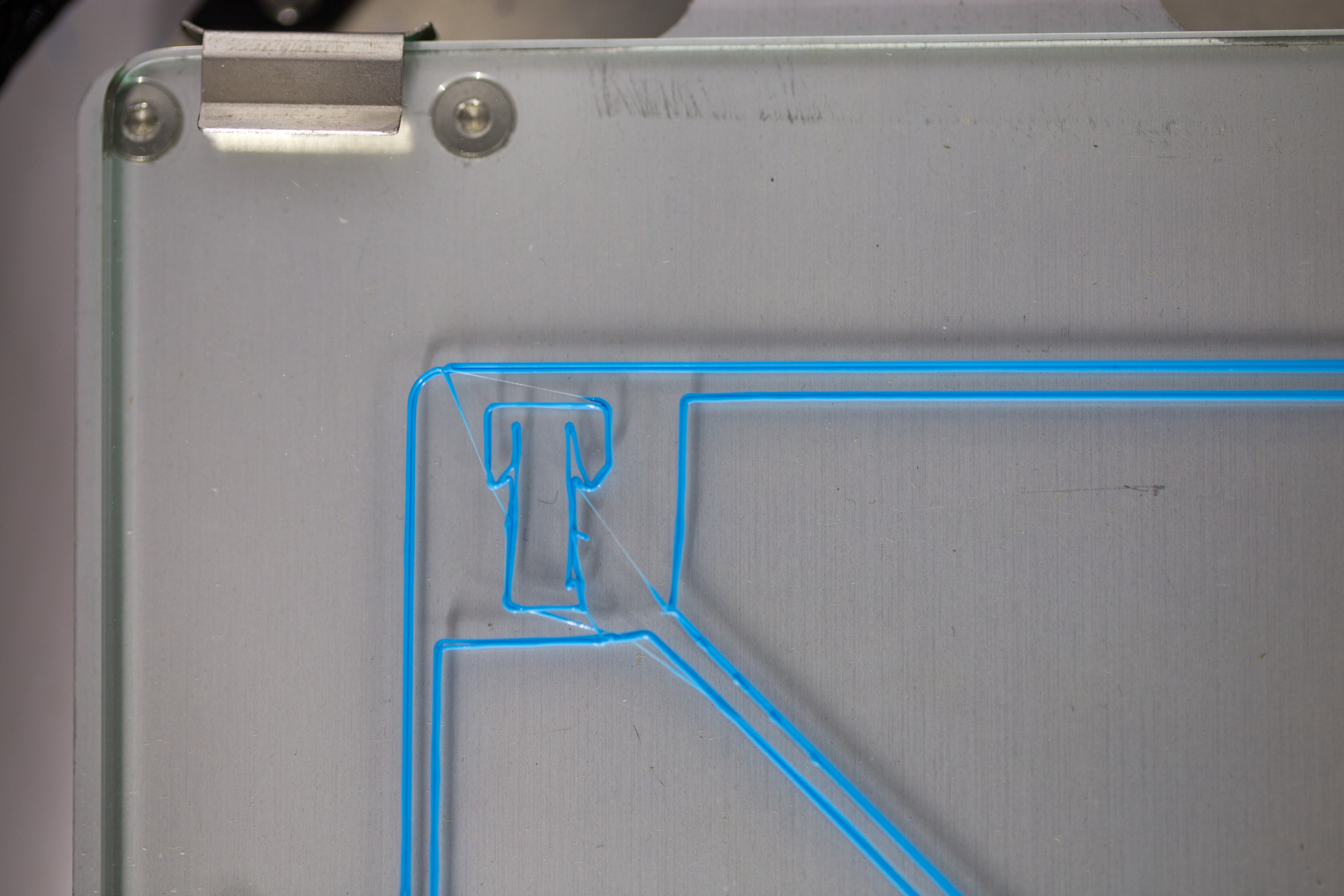

problem region left upper - filament is not sticking to bed
problem region right upper - feeder clicks - too much resistance pushing the filament out (good chances of clogging)
any idea?
is there a way to fix this Issue myself?

    Not sure about this but maybe there is something that makes the plate higher on the upper right and a bit lower on the upper left.
    Maybe check the screws (not sure what screws).

    yes, something is way out of plane
    the glass-plate is flat (definitely)
    could be the L-shaped part which attaches the buildplate to the Z-rods
    could be a bent x-axis
    could be a bent chassis
    i can only see 3 relevant screws which are accessable without taking the frame apart...
    I#m aware of the levelling bugs, I tried the whole procedure in Cura 14.03 and 14.07, this issue is definitely Hardware-related.
    maybe I should try Chapter C3 (stabilize z-stage) from the assembly manual, but I#m not very motivated and talented doing that :(

    I suspect your gantry rods are out a bit. The rear X rod is probably not level with the front X rod. Is the box of your machine warped? Do the 4 "feet" sit level on a flat surface or does it rock? More important are the top 4 corners level. Shipping companies like DHL seem to employ elephants who sit on the boxes during shipment.
    What do to about it...
    Well first of all: Ignore all the criticism or suggestions of another leveling technique. Your technique is fine. There are many good ways and no matter how hard you try you will always have a problem because something is slightly off on your hardware.
    How thick is the layer you printed? What is your bottom layer thickness? If you are seeing this kind of error with a .1mm layer then you can fix this a bit and it's as good as most ultimakers. But if this bottom layer is .3mm thick and you see this kind of error you need to get it fixed.
    My only quick solution to your problem:
    First realize that if you want to lower the back right corner (which you need to do) you need to raise the front left corner a bit. So what I'm saying is you can distribute the error more evenly. So I would raise the front left corner 1/4 turn and lower the front right corner 1/4 turn and don't touch the rear screw. Then repeat the test until the overly thin section currently in the rear right corner matches the front left corner - you want equal thinness there. Also you want the rear left corner to be overly thick by the same amount as the front right corner.
    If this compromise "best fit" leveling is not good enough you need to twist the UM2 frame or the glass. Probably the glass is easier. You could try inserting a .1mm shim (a small piece of paper) under the rear left and front right corners of the glass. That will warp the glass to match the gantry above. You might need 2 pieces of paper.
    I'm really curious to know if this paper warping solution works! Let us know because if it does there is a second person on the forums who has the same problem as you.

    my the chassis of my machine is definitely warped, it's sitting on 3 feet as you can see here: http://umforum.ultimaker.com/index.php?/topic/6050-um2-housing/&do=findComment&comment=60758
    the initial layer thickness was 0.3mm at this print (layer height 0.1mm)
    I made another print with an initial layer thickness of 0.1mm. which you can see in this photo (collage for more detail - highres )
    I used the distribution of error method on this print - it is the best I can get
    so my next option is twisting the frame or glass which i will skip for the moment.
    finally I tried a similar method to your paper warping idea, which is a nut right under the heated bed, to raise it a small amount. I hope you can imagine it with this photo (the smaller screws are from the left backside clamp)
    I did several loops of the bed-levelling-wizard, and I noticed a very slight change to the better (at least for the back left corner). Further trials tomorrow.

    The warp on your foot of your UM completely agrees with expected leveling errors you are experiencing. One way to think about it - your right front foot and left rear foot are "high" so you the gantry will be warped the same way (right front, left rear high) so you can warp the glass by a similar amount - raise right front and left rear corners of the glass.
    Ideally you should be able to put the whole thing in some kind of vise that pushes down on those 2 corners until it sits flat on the table again. But in practice I'm not sure it's possible. I guess you would want to loosen and retighten all the chassis screws while doing that. :( I think you are better off with the glass-warping technique.
