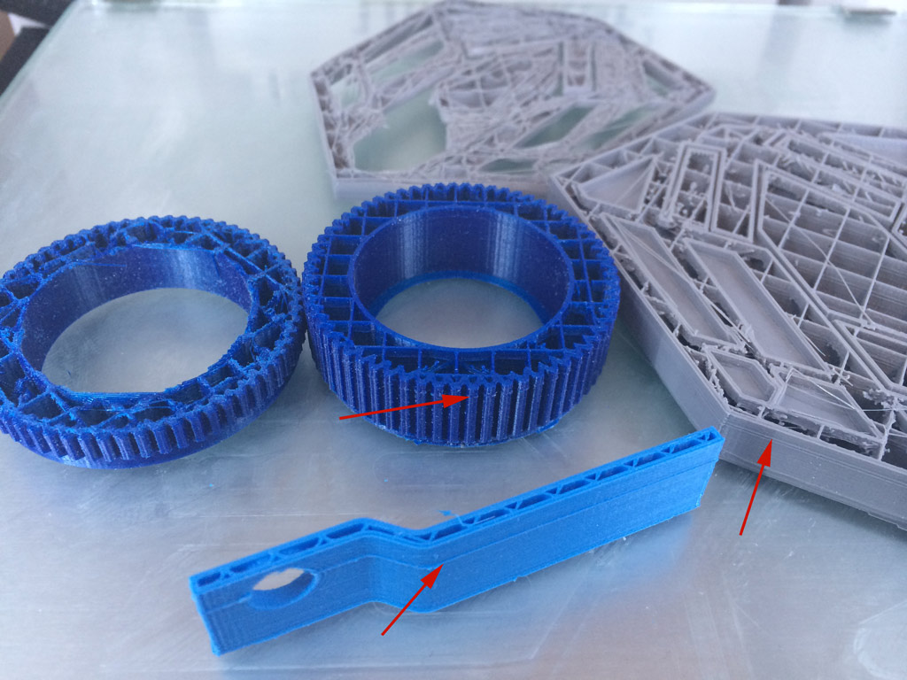

After a promising start with my new UM2, I have started running into problems. Two major prints have failed spectacularly:
http://umforum.ultimaker.com/index.php?/gallery/image/4090-chaos1/
http://umforum.ultimaker.com/index.php?/gallery/image/4091-chaos2/
Here are my settings:
http://umforum.ultimaker.com/index.php?/gallery/image/4095-settings-p1/
(How do I get these into a text file?)
Using standard Cura settings besides lowering the print speed slightly and the brim to 5 instead of 20 since the models have a lot of flat areas. The failure occurs at random intervals somewhere mid-print. Since the print is so long it's hard to catch the machine "in the act". These should be simple prints to do.
Is this a heat issue? An issue with filament not being pulled through?

    So what is causing this? I'm not sure. It looks like some parts are printing perfectly and other's aren't? Is that correct? Or do you have prints from 2 different runs placed on the same platform?
    1) It sure looks like much more glue than you should need. You can't really see the glue on my machine - it's very subtle. Too much glue can clog the nozzle on the first layer. I doubt this is your issue but still...
    2) What's your print temp and bed temp? Bed temp off (0C) might explain some of this - I recommend 60C.
    3) It looks like some parts are perfect and other's are printing over thin air - is it possible that some of the parts don't start until maybe the 5th layer or so? Because it looks like it is printing them in air or that they never stuck to the glass on the first layer. Maybe your levelling is off towards the front of the machine so that it is not printing on the glass on the parts near the front but printing above the glass.
    Or maybe you combined different prints in the same photo and that is confusing me.
    This does *not* appear to be typical underextrusion despite what geeks says. Although it is possible.

    It's actually photos from two different print runs. Two completely different files. It doesn't appear to be a first-layer issue because it happened halfway through the print the first time around. It's like all of a sudden the filament stopped sticking to the previous layer. The ambient temp in the room didn't change... the only thing I can come up with is if the filament had trouble unspooling. I'm using Faberdashery stuff and it didn't want to properlyspool around the stock UM reel so I've had it laying on the side. (I'm going to try a lazy Susan setup instead)
    1. I added lots of glue because I had initial problems with models coming loose. Also... I'm finding it extremely hard to get models off the build plate without lots of glue on there. (The glue makes it easier to get a spatula under the model.)
    2.Whatever is standard for the UM2. (I don't even know where to check this yet... I've been afraid to tamper with those settings.)
    3. I think, after som further testing today, in one instance it may have been a 1st layer problem but the second photo (the one BIG piece I am holding in my hand) is the bigger mystery. The print was more than halfway through when the problem started but it does seem to have begun when some details were being "capped".)
    I did level the bed rather carefully... I may have been TOO nipicky.

    I am bringing this thread back, because I am seeing this problem more and more.
    After printing about 1cm up (more o less) the print starts failing and "skips" a few layers and starts pulling strands of filament all over the place, only to resume again as if nothing was wrong. I'm having difficulty finding any consistent pattern besides the height, which makes me wonder if there is a hardware error or damage to the mechanisms that maybe stops the print bed from moving properly. It seems to ALWAYS happen at the same height.
    Some things I can more or less conclude:
    - bed or print head temp has little effect (tried different settings)
    - material feed possibly catching on something does NOT appear to be the issue because I've tried many different variants and I know that at least one of them is guaranteed NOT to "catch" anywhere. If there's an issue it could be within the feeder... but why would it be so consistent?
    -bed has been leveled very carefully.
    -doesn't matter if I print ONE big item, one smaller item or lots of items... it happens anyway.
    -it doesn't ALWAYS happen... but maybe 20-25% of the time.

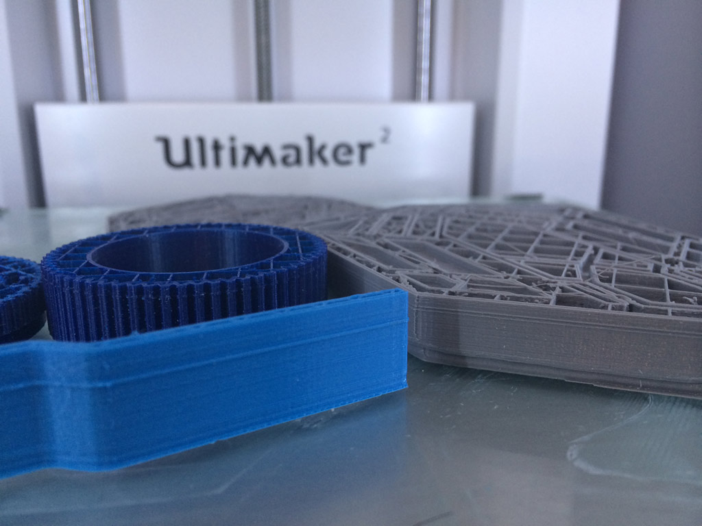

    Well, the hardware thing is the only thing I can come up with unless there is something wrong with the software. Wil measuring with a caliper be reliable though? I mean, the build plate is a bit "springy"- so much so that measuring 100 microns can be difficult.
    Here are some more photos. I also noticed that the "split" seems to be preceded by a couple layers not aligning properly (see the red arrows). It's not in the EXACT same spot each time, but pretty close... and the differences COULD be due to the position of the bed leveling screws in comparison to the screw that holds/moves the platform. I'm going to send this to UM support as well.
    Note: I did some cleanup on the blue parts... they looked just like the grey one at first with strands of plastic everywhere.

    My headache grows.
    I just got home and did a test.
    First, is the ultimaker 2 supposed to make a NOISE when the build plate is lowered during printing? Whenever my buildplate is lowered as part of a print, I hear a short "grinding" noise for a fraction of a second. Kind of like a "Ksssht". I felt the plate screw with my finger as this happened and I felt it turn slightly so I know that it occurs when the plate is lowered.
    Second, I watched the print going and it looks like at one point, the build plate fails to lower for maybe a level or so, causing the filament to "smush" as it is printed. This creates the misaligned layer that shows in the prints.
    Third, a few mm later I watched as the build plate DROPPED 1-2mm in one go with a small "kadunk"! The print immediately failed as the new layer had no old layer to grab onto and I stopped the machine.
    So, the question is- what is causing this? A loose gear or something somewhere? Any ideas?

    Yet another discovery. My build plate is LOOSE. I can pull it up or down maybe 2-3mm. The screw doesn't seem to move, so there is something loose inside where the plate attaches to the screw...

    You are doing great! You have definitely proved the problem is in the Z bed movement. If power is off you should be able to raise the bed by pushing up and down on it firmly but don't do this on the front edge - do this near the back of the bed near the screws and such.
    It is true that the Z motor is very noisy compared to everything else on the printer so it's hard to say if what you heard was normal or not. Maybe 10X louder.
    Is your Z screw coated in green grease? It should be. You should have gotten a tiny packet of green grease with your UM2. But I don't think that is the problem. I think something else is loose/broken. It's okay to *oil* (not grease) the 2 vertical metal cylinders with a light petroleum oil. Any petroleum oil will do preferably with as few as possible additives.

    Yeah.. that's definitely not how it's supposed to be, there shouldn't be any play at all. Unfortunately I haven't personally torn the bed assembly apart so I don't really know where to start on that.
    Posted · Chaotic mess... is this underextrusion?
    Well, I removed the two screws holding the cover and looked under it. There's a brass washer/ring held in place by four bolts to the build plate. I assume that the brass ring is threaded inside so that the screw can move it. This brass piece was NOT loose, so there is either a washer or something underneath that is faulty or the brass piece itself was machined defective. There's not much more I can do until UM get back to me with instructions. Removing two screws to look under the cover is one thing but I'm not going to start disassembling the build plate without the go-ahead from UM. (I can't fix anything until I get replacement parts anyway.) Sigh... I'm in full production of a prop kit at the moment too so I can't really afford to be without the printer for long.
