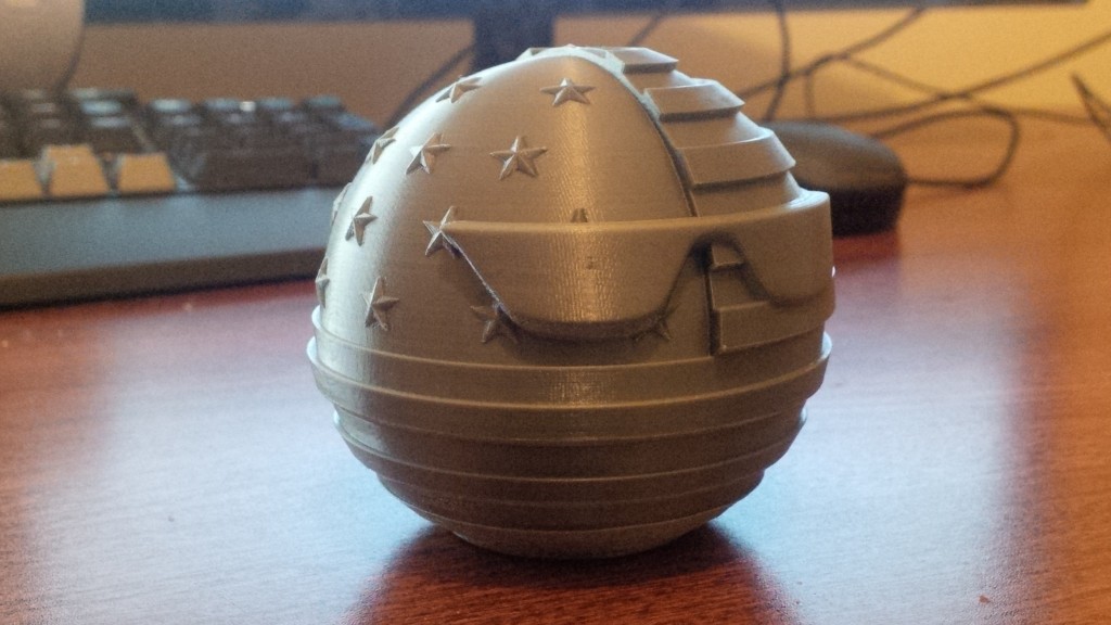

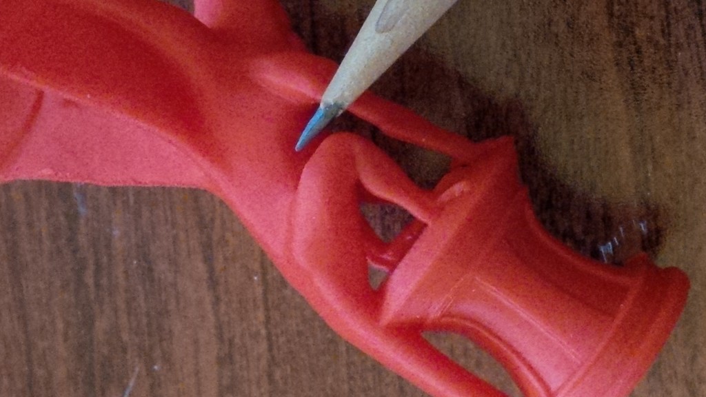

    Here's some 0.06 prints
    In my experience,
    0.04mm is even better quality (sorry no photo for now)
    0.03mm and under, the quality actually starts to degrade compared to 0.04. But this could be due to my temperature not being correspondingly lower.
